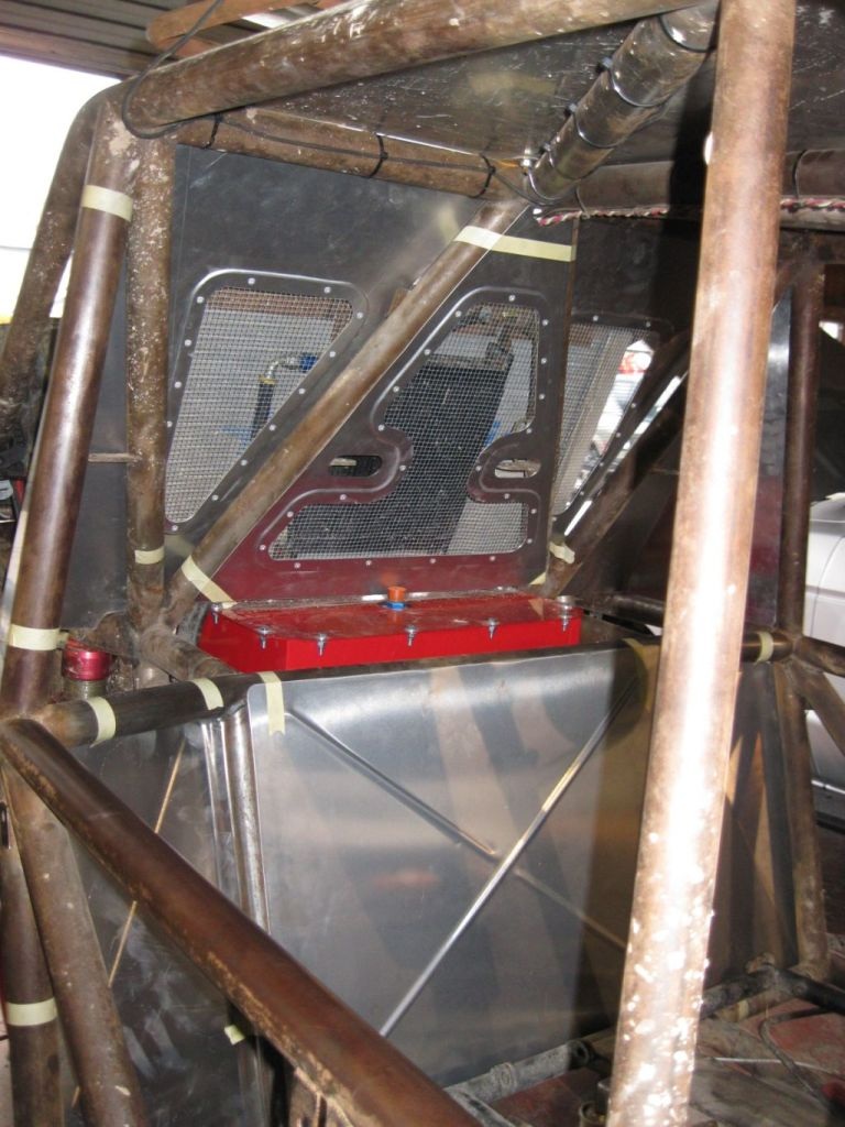

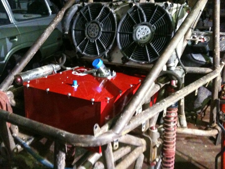

Ya esta por salir el press release de nuestro team que se ha juntado con Javier's Gulf Coast Crawl Shop (Dave Gutwillig, Javier y Marcus Ibarra) para correr esta carrera del King of the Hammers 2011.
El vehiculo que estabamos armando para este KOH era un Jeep Speed Class 3700/Ultra 4, con estos specs:
Chasis por Kevin Hunt y Ponce, Engine - 4.0 with Stroker Kit, Front Axle - Ford high pinion Dana 60 with 4.10 gears, Detroit locker, 35 spline Chromoly outers, warn locking hubs, Rear Axle - GM 14 bolt - welded with 4:10 gears, Front suspension - 3 link with Johnny Joints, coilovers and bumpstops Rear suspension - 3 link rear with Johnny Joints, coilovers and 4 FOA bumpstops Transfer - Dana 300 with twin sticks for lowmax 4 to 1 crawl ratio, 32 spline rear output Tranny - AW4 with extra AW Shifter control Steering - Hydraulic assist Brakes - 4 wheel disc brakes Tires and wheels – 37 BFG KRT's on Allied beadlock wheels, Wheelbase 113", FOA Bypass Racing Shocks and 2.5 Rear Coil Overs con Resevoir, Being prepped with FIA gear to pass Ultra 4 tech and race in Jeep Speed 3700 and Ultra 4 Class Esperamos terminar el vehiculo para verano y participar en el Ultra 4 Series y Best in the Desert, y Texas EDR Series.

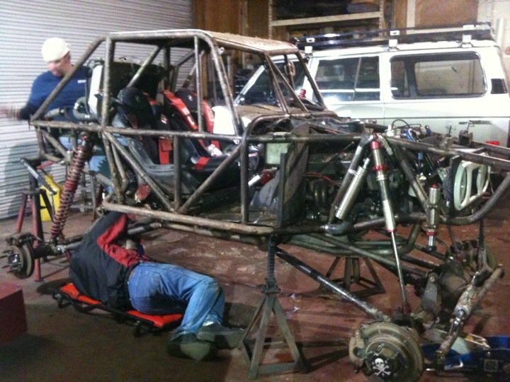

Dave Gutwillig y el Javier's GCCS crew estan trabajando muy duro como pueden ver en las siguiente fotos en los ultimos detalles para tener el vehiculo listo para escrutinio y correr duro 120 millas de desierto y rock racing. Este buggy se esta terminando a las especificaciones de ULTRA 4 Racing, para poder correr en el King of the Hammers, Ultra 4 Series, Best in the Desert, Texas EDR Series, y Baja 500 y 1000. Los specs de este GCCS buggy son Chassis Builder – Javier’s Gulf Coast Crawl Shop, Engine – 5.7 Chevy Vortec, Transmission – Turbo 350, Transfer Case – Atlas, Front Axle and Locker – Spider 9 inch with 4:56 gears , Rear Axle and Locker – Ford 9” with 4:56 gears, Wheels – American Racing with Stuan Beadlocks, Tires – 37" Goodyear MTR, Shocks – Custom Swayaway Bypass and Coilovers, Ultra 4 series safety specs. Este es el buggy que se va usar para esta carrera del King of the Hammers 2011.
Aqui estan algunas fotos del vehiculo de Team Mexico.
